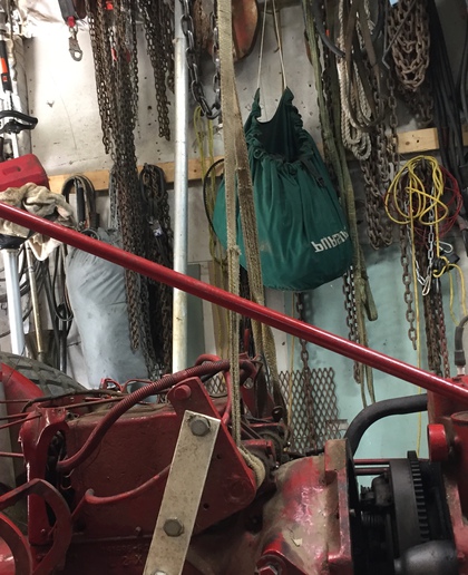

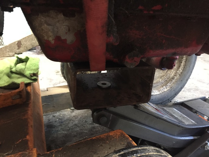

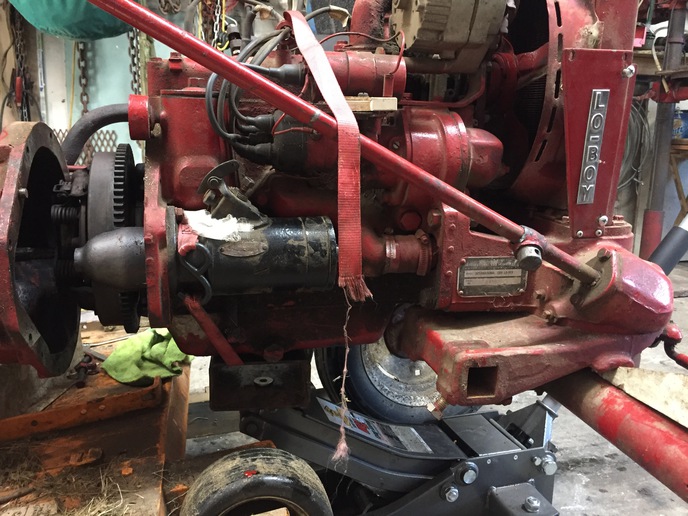

I thought I�d share the throw out bearing replacement. I replaced the stand on the jack with a large piece of square stock and strapped the engine to it. I was able to leave the mower on. 3 hour job
