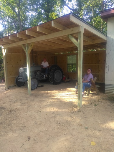

2-2x12 should be ok.....rows of 4 nails every 16 inches. And maybe some nuts and bolts. How long are your rafters? Tin or shingles? We just built this for my folks.
Central AL. Hardly ever get snow.
