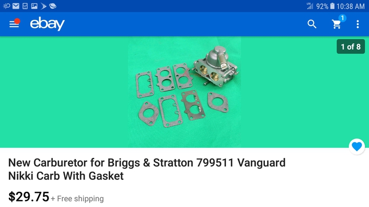

Hey Junkie, bet you are running on half an engine. Take the air cleaner off and
grab a squirt can with gas in it. With the engine running stick the nozzle down
into the throat. Pump some gas ALL the way to the right and then ALL the way to
the left. If the engine suddenly smooths out into a nice purr, you need a new
carburator. What happens is the carb gets out of balance. One side is running
1/2 fuel and the other side is 1 1/2 amount of fuel, thus your messed up plugs.
Very common problem with the ethanol eating the carb components. Done several
of these engines and they run beautifully after the new carb. They are cheap on
Ebay. Take you maybe 1 1/2 hour for a newbie. Just make sure you put that
little metal airflow plate in the correct way around. Factory modification. Try
a set of NGK plugs. BPR6ES. If you really love your engine, go on Ebay and buy
some NGK IRIDIUM plugs. They are BKR6EIX-11. These engines really love them.
Also used hi-test gas. Thats all I got.
