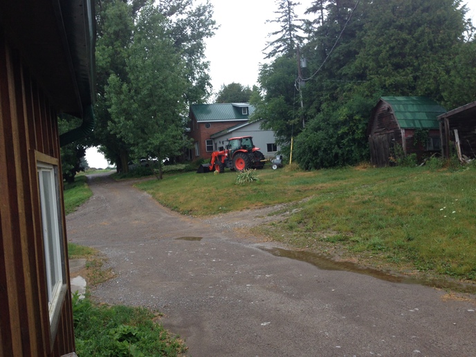

I have a pto generator, and I connect it to a pole switch. It shuts off the grid, so I am not sending power down the line that could shock a power worker, that is working down the line to restore power. My generator is big enough to provide enough power for both my house and dairy barn to operate as normal. And requires around 80Hp tractor. I just use whatever tractor is handy. Longest I have ever generated our own power is two days. Obviously this is more than what you would need just for a house, but a pole switch is a must in my mind, and not cheap to buy, or have installed. If you are on natural gas, I would forget the tractor generator, and put in a dedicated gas unit, connected to the natural gas supply.
