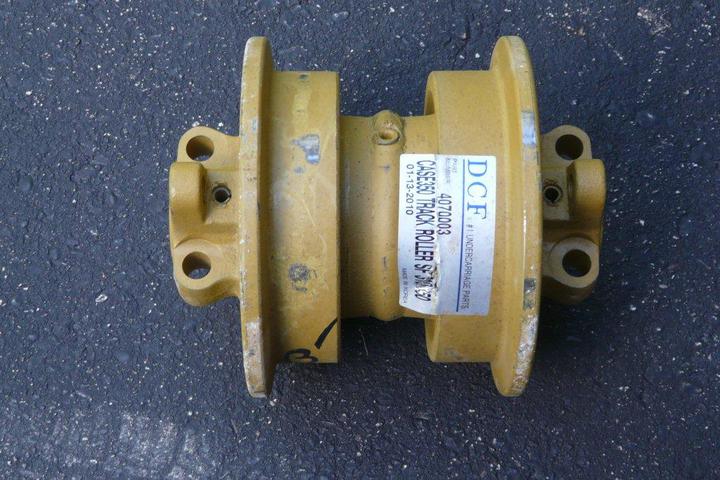

310G is a crude machine (in a good way). Especially if all gear drive. The transaxle in it is made by Clark Corp. so parts are easy to get. Same basic transaxle as used in Oliver HG and OC3 crawlers. Using the wrong oil in the trans can plug up the steering brake bands pretty fast. Never supposed to use any GL5 oil in it.

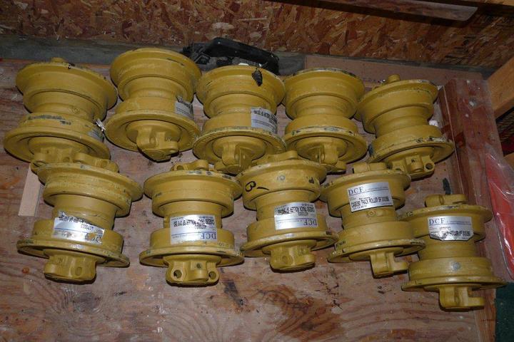

I bought brand new rollers for my 310G a few years ago. I was happy to discover that there are crawlers in Korea that use the same rollers so they are still made new in parts of Asia.
