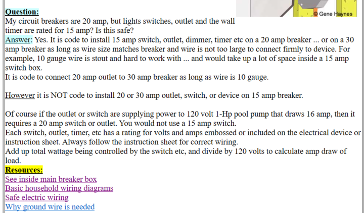

Reading the post below about how code allows using 1 side of a 220 breaker to run a 110 circuit got me to thinking.
So answer this code question...�
How can electric code allow you to put a 15 amp switch/outlet on a 20 amp breaker as long as you use a 20 amp (12 gauge) wire??
BUT....
It is not code to put a 20 amp switch/outlet on a 15 amp breaker.
That seems backwards. Seems to me the breaker should be the smallest amp rating of the circuit so it protects everything in the circuit.
