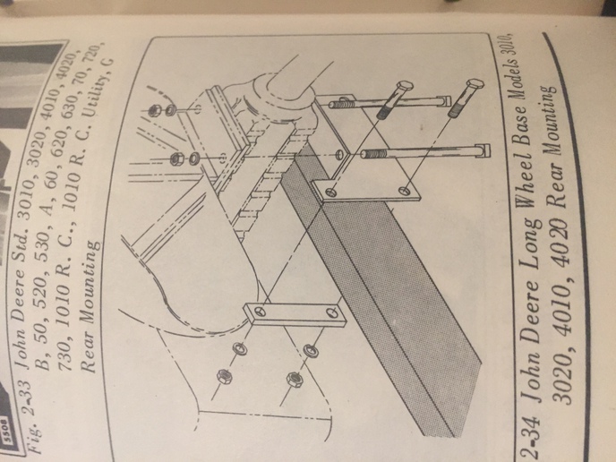

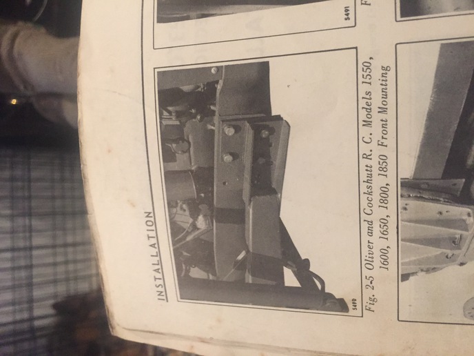

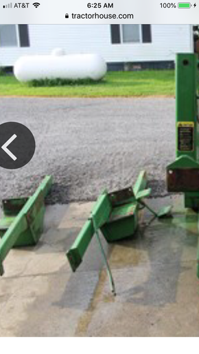

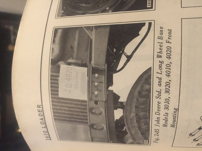

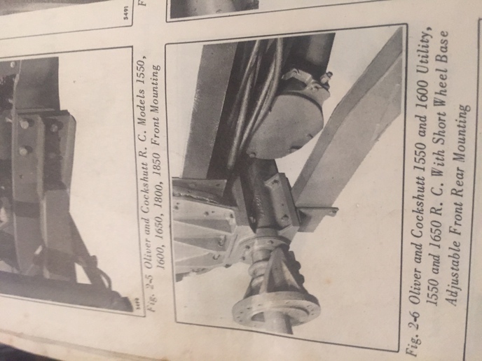

Mike, I looked up the loader on tractor house to see what the mount looked like. I have an Oliver 1610 manual and it lists all the mounts available . Hate to say it but looks like the Oliver loader fits a John Deere better than a 1650. Note the 3 bolts holding the front loader frame whereas 2 for the 1650. 2 bolts hold the spacer.
