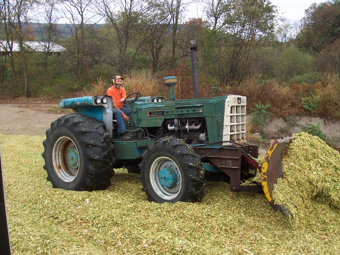

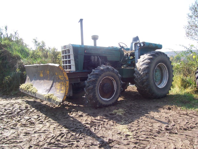

this is the silage pusher on Earl, my Oliver 2150. I built the subframe from 6" (iirc) channel iron. it has been twisted, reinforced, and rebuilt a couple times. the blade was a snowplow from a F-600 size dump truck. there were plenty of bolt holes on the front and sides to use for mounting it. contrast to my White 2-105 4wd that was going to be Earl's replacement- very few places near the front to bolt and support a subframe, so the 2-105 is still a field tractor. Earl has power steering, but it isn't 4020-easy. I used a hydraulic cylinder with a 10" stroke to be able to get down pressure for digging in the silage. same length as the standard 8" stroke cylinder that I started with.
