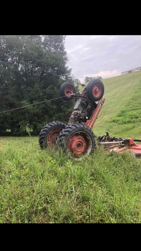

In a separate incident that happened a few miles from here recently, a man just barely escaped injury while using the tractor seen in the attached picture. I am acquainted with the man who was operating the tractor. He is probably early to mid seventies in age. I was told that he said that tractor front end got light as he started upgrade pulling large rotary mower. He pushed in clutch to stop, his foot slipped off the clutch pedal and the front end came up. For some reason the tractor stopped in the position seen in picture. Needless to say, a VERY CLOSE call.
