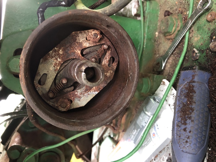

Brain surgery on my JD distributor
Posted by grayrider on August 27, 2019 at 16:16:41 from (174.223.12.246):
Been working on the old John Deere 60 all summer a little at a time, was ready to install wires, plugs, points and new cap this evening and when I removed cap I found that the entire plate underneath was a crusty rusty mess, couldn�t get any screws loose, all stripped and rusted tight. Wish I had of taken a picture before I finally had the idea to cut it out with a dremel tool. So now I�m in need of the plate, any ideas on finding one would be appreciated, found one on eBay that I believe will work.
No telling how long it�s been since this tractor last ran, hope this is my last surprise with it....
