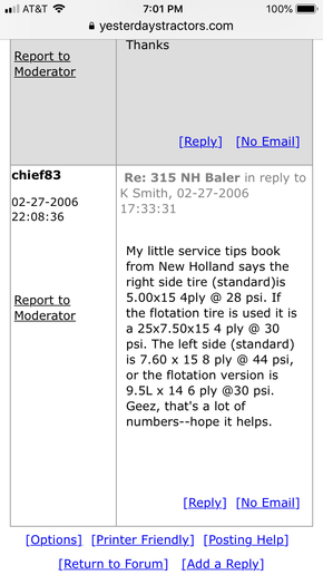

Kevin, I found this from an old YT post.
