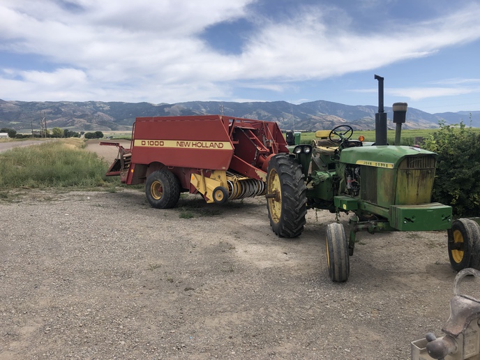

Brought this back from the dead . Found the knotter was about 180 degrees out of time . Also found I have more than enough tractor I can bale in 5th gear on the powershift 3020 , also found out I need to tighten the needle brake it�s letting the needles drop into the bale chamber over rough ground it does fine going slow . Made 5 bales tonight and have up have to go to work In the morning the hay In this field is 90^% junk anyway

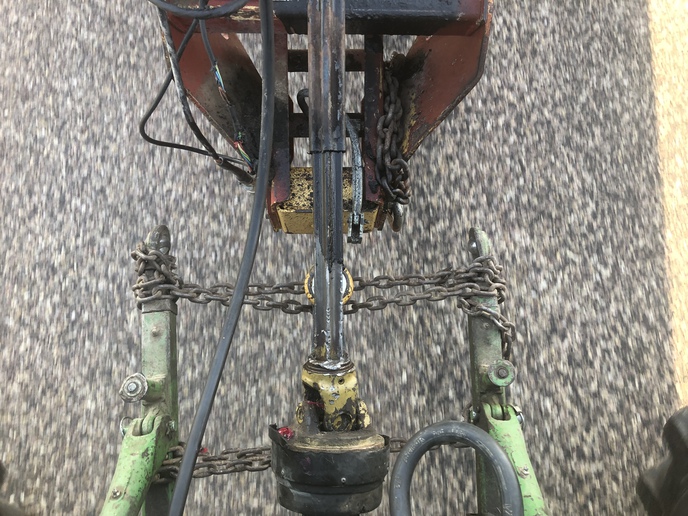

Had to give the drawbar a little extra support headed up the road and the drawbar was flexing 3 inches up and down
