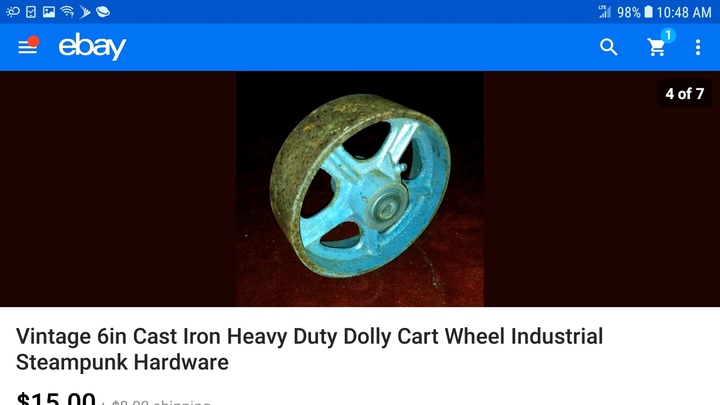

My guess is also fabricated. Some very
talented guys work in fabrication /
welding shops. Wheels like that were used
on gravely snow bloweres and were very
tough. Any high quality 6 inch wheel would
do. Industrial carts. Just as long as it
has a steel tube in it. That axle bolt
should be cross drilled with a grease
fitting. Have modified all of my wheels on
the lawn tractor decks to take grease. Work
very well. Just found this on Ebay, looks
perfect.
