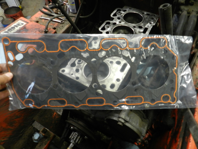

Just about got everything I need to put my Perkins 4.165 back together. This engine has been nothing short of a nightmare to work on. Seems any parts are hard to find. I found a water pump that is close enough to being correct just need to be modified to fully fit. My head that came off engine was welded once already so it was junk. The place it got sent to somehow had one sitting there (extremely lucky) just missing the combustion cups.
I managed to find torque specs and valve clearance. Looked it up under 4.154 (same engine family). Head bolt torque is 85 ft-lbs and valve lash is .012 cold. Just can't seem to find if the head bolts are torque to yield? I'm assuming not because few overhaul kits I found did not include head bolts. Also I know some people like to use their favorite brand of sealer on head gaskets. So I'm wonder if I should use a sealer on this one or not? It has silicone impregnated into the gasket around the coolant and oil holes.
