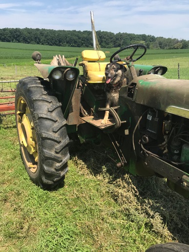

I have a 2010. Drain the hydraulic fluid and pull the filter from the access port. Wash the filter in a solvent. I used gas. Scrub the pleats well with a toothbrush. Put it back in and install new transmission fluid.
