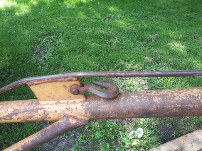

If you buy one pick up a grab hook while
you're there. Drill a hole and pin it to
that tab on top.
I got this idea from board member Hobo
NC and use it a lot.
