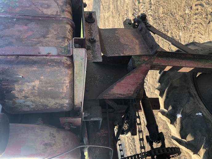

Battery box under gas tank with the rear part of steering.

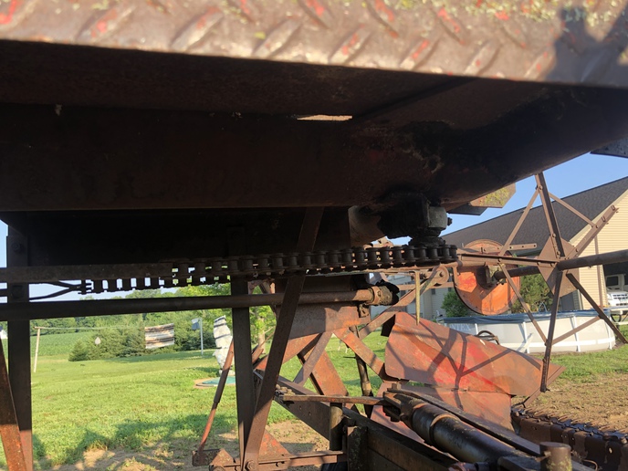

Bottom of steering pedestal. Chain goes to the rear.

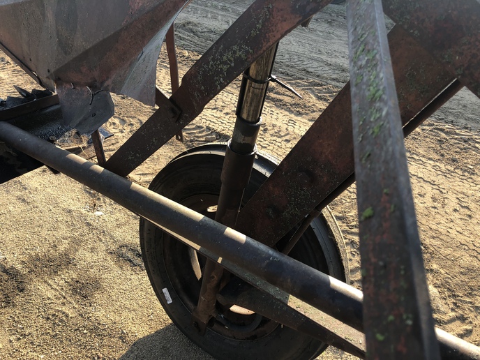

Platform lift, single acting cylinder on each side.

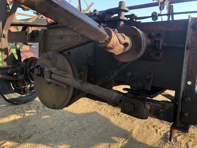

Sickle drive on rear center of platform. It�s hooked to a walking beam that goes to the center of the sickle.
