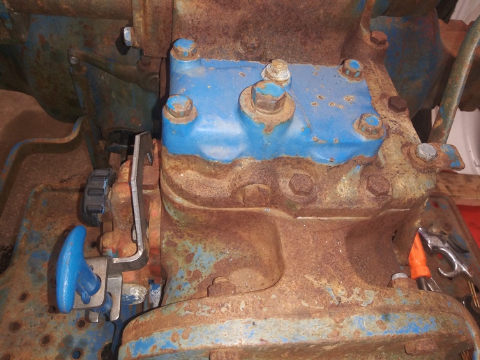

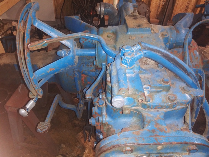

You will generally see them called a
remote valve.
As Showcrop said it is a simple matter
to remove the block off plate and
install a single or dual valve in its
place.
New ones are nearly cost prohibitive -
like $1200? for a dual and probably 800
for a single. I would look for a used
one and expect to pay about $250 for a
single and $500 for a dual.
There are several different styles. I
don't know that one type is better than
another. Ford used the exact same
mounting base and valves on all of their
under 70? HP tractors from 1955 all the
way up to 1983 that I know of.
So any valve from a 600, 801, and
2/3/4/5 and 7000 plus all the
2600/36/46/5600 tractors are a direct
bolt on for your 801.
First photo shows a single on a 4000.
Second photo shows the block off plate
under the seat on a 4600.
