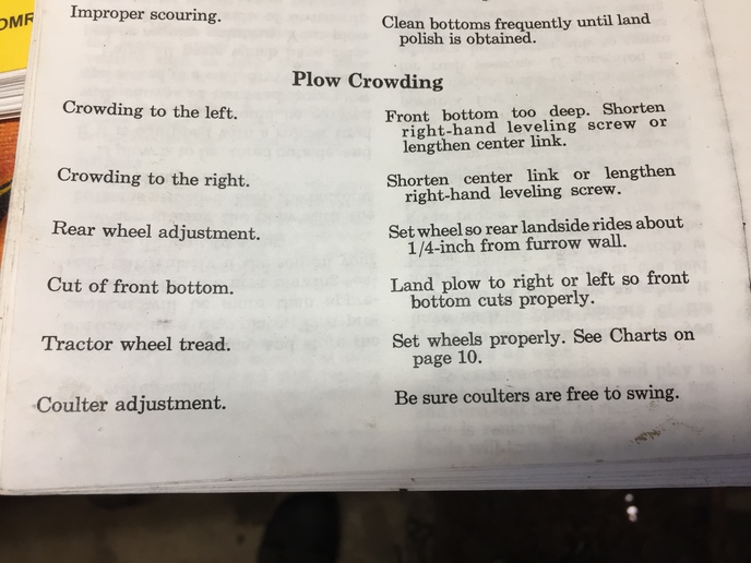

Re: Adjusting a plough
Posted by Fordy20 on June 12, 2019 at 16:42:47 from (107.77.205.142):
In Reply to: Adjusting a plough posted by 550Doug on June 12, 2019 at 10:00:00:
Siri troubleshooting guide below. Depending on your plow with your wheel should be sit around 24 to 25 inches from the center of the tractor to the inside of the wheel.
