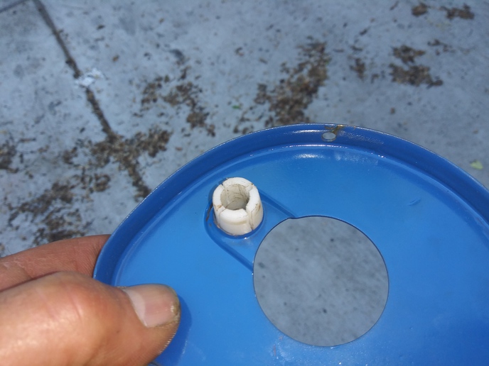

Wish I had a lathe.
Posted by Ultradog MN on June 07, 2019 at 17:24:23 from (172.58.84.108):
Ran one in the Navy so I know what one will do.
But I don't have a lathe.

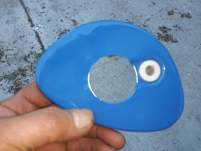

So this evening I contrived this bushing on a bolt in a drill that was clamped in the vise.
Friend gave me a piece of delron and drilled the center hole for me.
The old bushing was rubber and was gone long ago.
Between an angle grinder, a couple different files and a hacksaw I got a bushing I like.
It snapped in there tight.
Will probably outlast a rubber one too.
That's my story and I'm sticking to it.
