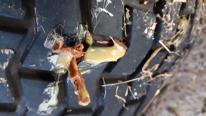

My 2 cents. Do you remember the rubber plugs for Bias tires? Looked like big black pieces of liquorish . I have found the best rope type plugs are the Camel brand. They have been very reliable for me. Other brands leaked. Also I no longer use the little tube of rubber cement. Now use Weldwood contact cement. It is always in my tool box anyway. Just goop some on and things Don't leak! The round type
with the long string looking thing are the best as they can be used on any type of tubless tire but you need the fish " insertion tool" to get them in.
