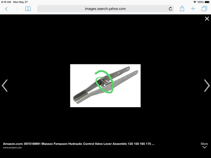

Problem #1: When removing top cover, I did not remove the roller from the control valve lever on the hydraulic pump. I was unaware of this...now I am.

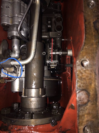

I have the control valve lever, the roller on the top is MIA. The lever sits back in its natural location without problem. What I cannot seem to wrap my head around is what happens at the middle of the lever. There is a small flat plate with a hole in it that rotates around a shaft. Circled in green, picture 1. A small, indented piece of metal was also in the hydraulic oil when I found the lever after pulling the top cover. That seems to snap into that smaller hole. I can�t, in any reading, figure out what attaches here. If the flat plate were to face the engine side of the tractor, there is a hole in a plate which lines up and a tiny hole in the pump body about 6� away. This is indicated by hypothetical red line in picture 2. Is there a small spring or something there that I have yet to find?

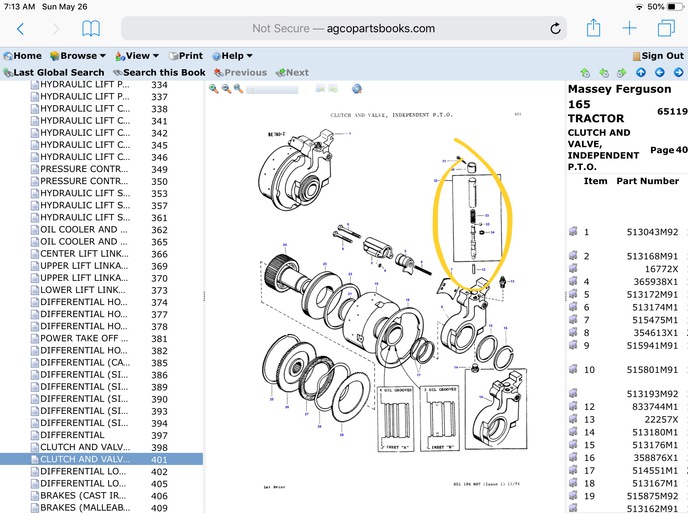

Problem #2. The IPTO. The P.T.O. handle rotates a shaft which moves another smaller shaft up and down into the P.T.O. clutch. I assume that this turns on/off the hydraulic flow to P.T.O. clutch. It appears to be stuck in the fluid-off position. The up/down actuator only moves downward 3/8� or so and hits something solid. Internally, I believe there is a pin and spring and a small ball in there. Picture 3, circle in yellow. I removed the cotter pin from the collar but cannot get the collar to separate from the shaft. Back to picture 2, circled in blue. Any thoughts? I don�t want to force it....should I unhook the hydraulic lines to the P.T.O. lever cover so I can pull that mechanism out to give more freedom of movement to the lever/shaft assembly?
Finally: The tractor had some work done by someone else a year ago, and it appears, that when the top cover was put back on, he didn�t put a gasket on. Any argument for not replacing gasket when I put this back together? Unbelievably annoyed with myself here. Making a medium sized problem into an even bigger one. Pictures might be reversed order when posted.
