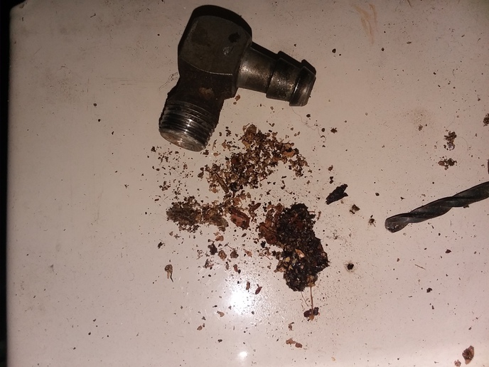

I thought I needed to change fuel filter
Posted by GEO-TH, In on May 03, 2019 at 13:00:16 from (184.19.62.217):
Instead the 90 degree fitting on the gas tank was full of crap.

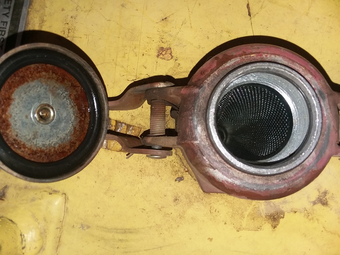

I think the gas cap may have been part of the problem.
I added an O ring to cap. There wasn't anything in the filter.
