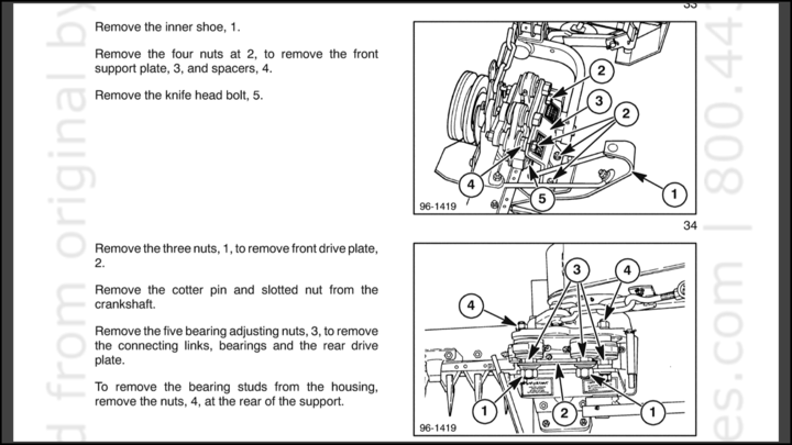

Re: NH 451 shear plate replacement
Posted by thethresherman on April 30, 2019 at 19:39:03 from (174.232.162.194):
In Reply to: NH 451 shear plate replacement posted by plumbwelder on April 28, 2019 at 08:08:13:
