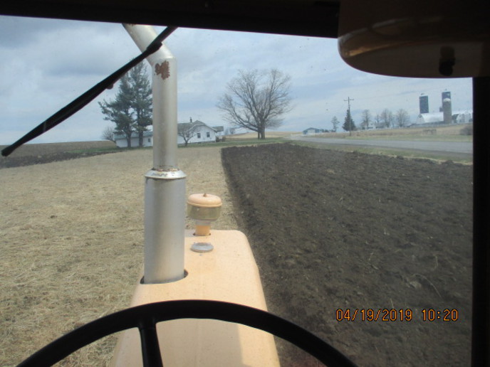

Paul I had no control over Case Co. when we were dealers, and I remained within the farm machinery business well after we closed our dealership, I sold what Case offered, and that was one of them.
I have no say up on the farm. One of the uncles died last Aug. and I am trying to fill his foot steps. He did all the plowing with a 7220 magnum and 6B Keverland plow which could not turn a decent furrow. (That is a story in itself. Wrong main frame for a 6B onland plow. The frame was built to fit at least 1-3 more bottoms on it. in order to center the line of draft).
The other uncle who is 86 and his son had never done any plowing so I filled the gap with my 931 and Case 8358 plow That they had abandoned in an old barn. I take pride in how well a field is plowed and there was no way I would plow with that Keverland plow the way it is set up. The draft beam pulls of the 5th bottom, not between the 3rd and 4th as a 6B plow should be set up.
