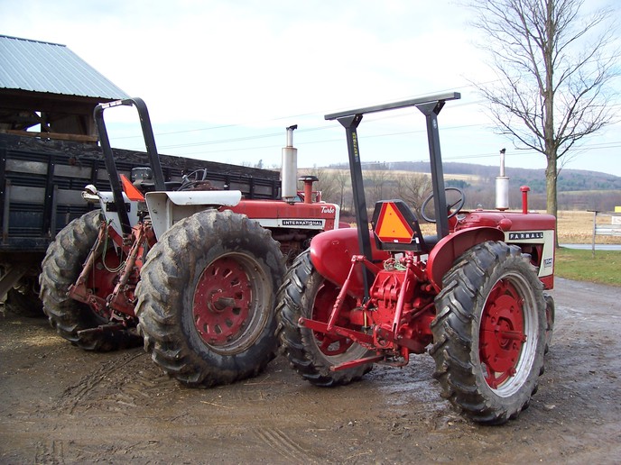

ROPSR4U.com the national rops program, coordinated from Cooperstown, NY. follow links to the Kentucky ROPS guide. it lists several for the 8N, but it appears that there is no funding yet in Al.
my buddy Steve put one of the CROPS onto his 600 Ford, but he thought it interfered with using the 3pt hitch. I don't know if that was resolved.
https://www.cdc.gov/niosh/topics/aginjury/crops/
I have put ROPS from Saf-T-Cab and Hercules on Farmalls.
the 1206 has the Saf-T-Cab rops, the 504 has the Hercules. both easy to install.
