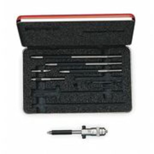

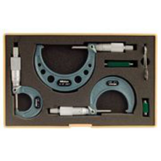

To be sure of the Brg. Shell required...Measure the connecting Rod Crankshaft Journal.
Take NOTE of Journal Diameter....compare Micrometer readings with diameter of Journal specifications of 640 Ford.
Probably .001US "One thousand Undersized BRG. Shell"
If the Connecting Rods are removed...you could assemble BRG. Shells back into respective connecting Rods & Caps...Torque caps and check I/D with inside
micrometer:
Bob...
