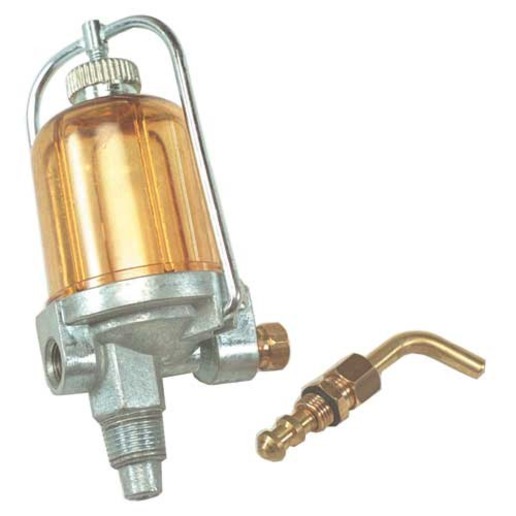

Look at this picture. You can see the tapered end on the valve. This seats against a machined surface in the cast part of the sediment bowl. This not mating/sealing is what is causing your leak.
Several things can cause it.
1) someone over tightened the shut off. This mars the surfaces and ruins the valve.
2) the seat or valve has a imperfection on them so the two will not seal. I have polished the needle part and then taken a drill bit and tired it backwards to smooth the seat in the valve body.
30 Manufactured incorrectly and the seat/needle are not centered on each other. This is the most common issue with the imported sediment bowls.
