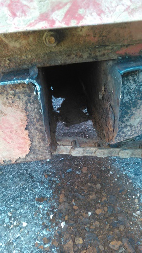

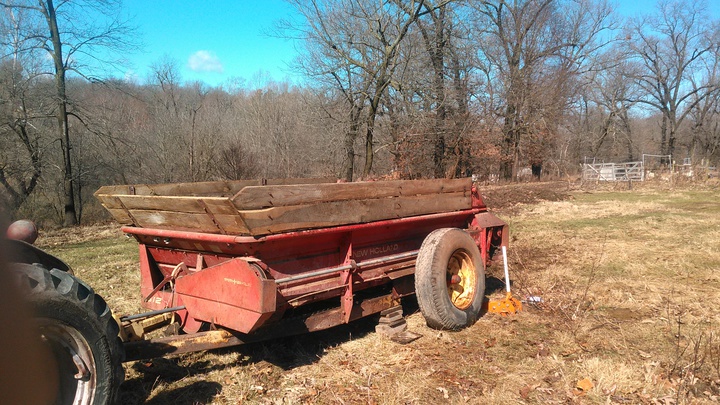

I set out to fix the axle on the manure spreader today. First step is to unload it. I just jacked it up and let it unload. Oops, I left a hammer on the ground behind it.

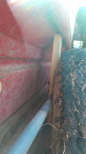

Now, brace the axle and drive very slowly to the shop.

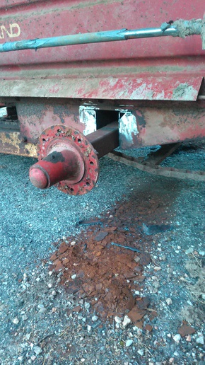

Cut off the junk axle ends...
Weld the axle stubs to a piece of 3 inch square tube... Anyone else forget to breathe while welding?
