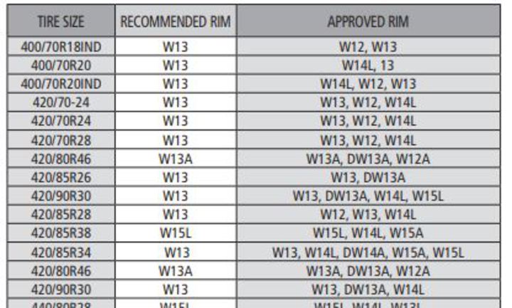

Different diameter tires with the same nominal section width can be designed for different rim sizes as shown by this chart. For the 420mm tires on a 24" rim like what your new Deere has the approved rim widths are 12, 13, and 14 inches. However, the approved rim widths for a 16.9-30 tire are 14 and 15 inches. There must be differences in how these different sized tires of the same general width are designed that makes them work best on very different rim widths.
(This chart is from the Titan Tire website but it is straight out of the Tire & Rim Association Handbook so the information is industry-standard and not brand-specific.)
