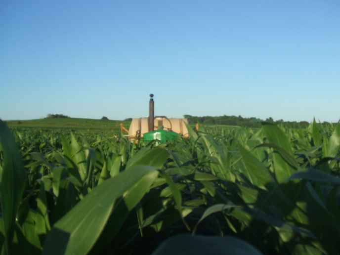

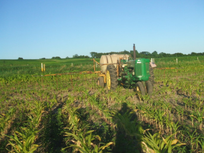

Do you have a sprayer? My brother set up a sprayer to dribble on 28% as side dress. You need a nozzle over the middle of each row, use an orfice( flat disc with a small hole in it) and fasten a piece of garden hose on the nozzle to reach almost to the ground, set the pressure and drive. I did it that way for a few years until I bought an old NH3 applicator and then used that. Sorry I can't
find a better picture. This is from 2010, it was really wet that year. The corn was stunted on the
east side of the field and hood high on the west side of the field. If you look close, you can see the hoses hanging from the boom.It worked well, just cost more than NH3. I can look around and see if I still have a book from Stutsman's that has orfice sizes and gallons chart if you want. Chris
