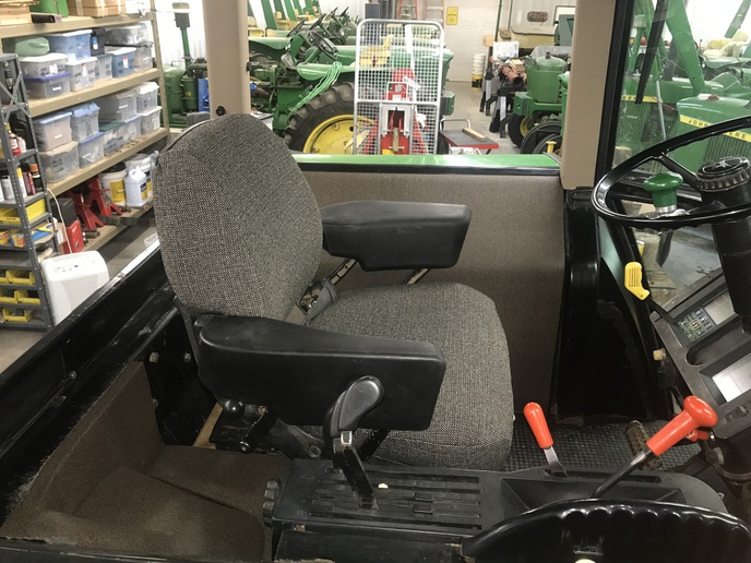

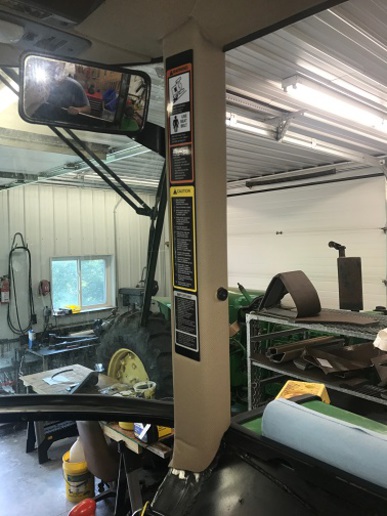

Well worth the money. For example the rear post coverings just snap in place, no glue. The fronts require a Velcro strip to be glued in.
Get all surfaces to be glued really clean if you want a great job.
I have done two Fehr kits on JD 4450 and 4055. I spent a lot of time cleaning but my result was fantastic. Fehr Cab was great to work with and helped to me successful when I had a problem.
Paul
