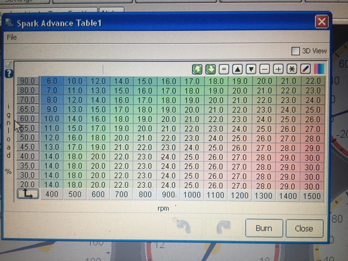

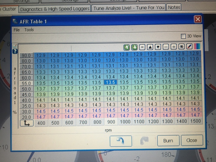

The talk about spark advance, distributor/magneto and carburetor mixtures got me thinking.
I made up the advance and air fuel (AFR) tables when I did the EFI MH44.
I am posting them here.
