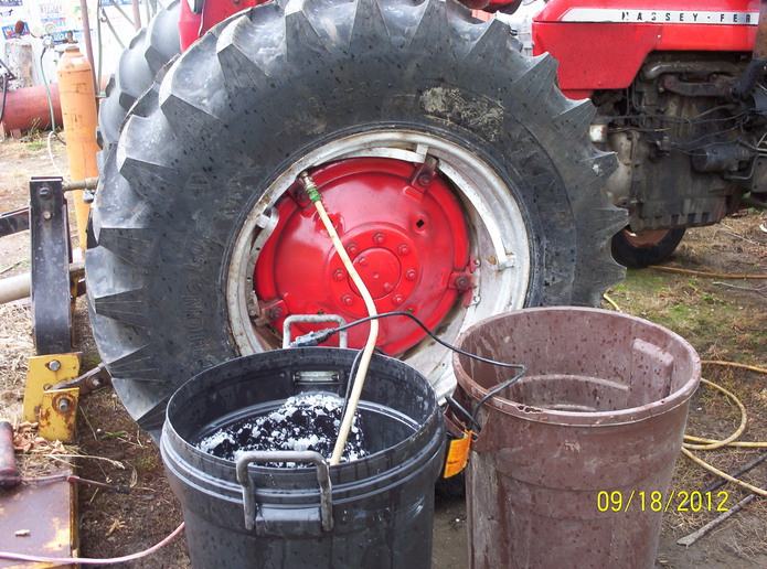

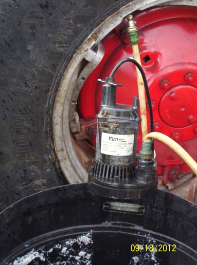

When possible I use air pressure to blow the fluid out of the tire. I have used a drill pump but it's hard on the pump and the chloride isn't good on the drill should any get on it. To put the fluid back in a utility pump works very good.
