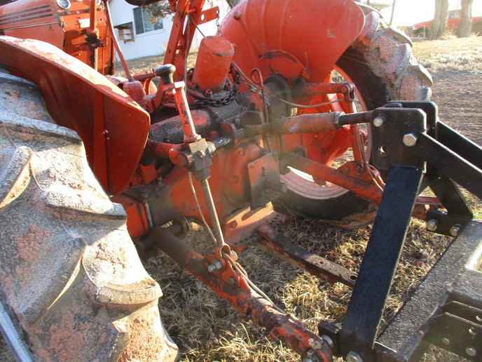

I'm doing a lot of work to my regular farm truck, a 98 chevy K3500. It's going to get the rear end overhauled, intake gaskets, exhaust gaskets, turn signal switch, ac compressor, and brake booster. With that truck laid up in the shop, I had to dust off the 68 GMC for farm work. With a new set of blue streak points, it was ready to pull the stock trailer and haul firewood. I was still having to feed with the tractor, and with cows on three places several miles apart, this wasn't ideal. I decided to rig up a spear on the old truck. I cut an old top link in half, and welded some pieces of pipe to the bed to slide the halves into. Then, it was just a matter of bolting on the spear and chaining on a winch. I still may pick up a cheap electric winch for this. It seems like it will work pretty good.
