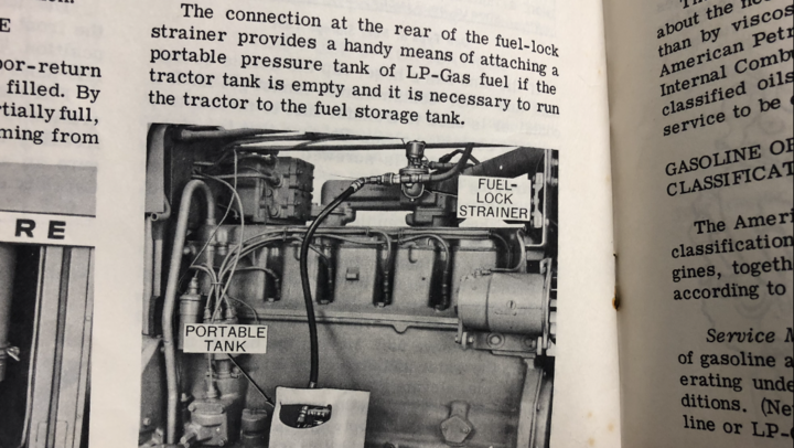

From the 4020 manual there is a connection for the small tank no need to take off or change anything
third party image
