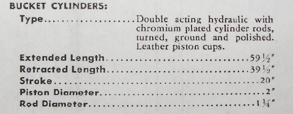

Well it gets kind of tricky. You can still get bucket cylinders from New Holland but they are $629.38 each. At the bottom is a link to Messicks which has the parts breakdown for the 703-Series loaders of which the 19-97 is a part of. Also I've included the specs for the bucket cylinders if you want to shop for generic replacements at Surplus Center, Baum, Northern, or Bailey etc. Specs also include 1" crosstube pins and 3/8" NPT ports. Good luck finding a real close match though. Are your current cylinders past the point of rebuild? If not I would pursue that.
