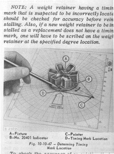

third party image
Air-timing is the easy way to check it and time it. If you really want to take the pump off and apart again -the timing mark is supposed to be at 48.5 degrees on your pump.
