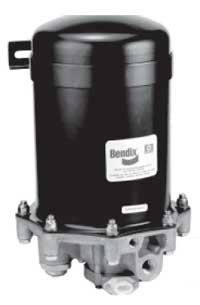

Is this the piece where the air is bleeding off?
This is the air dryer.
How it works.....
The air passes threw this dryer and stops water and oil from getting into the air tanks.
When the governor shuts off the compressor the compressor unloads.
There is a line that runs from this unload port on the governor to the dryer purge valve.
This air opens the purge valve to allow a burst of air to backwash the dryer.
There is also a check valve in the dryer to protect it.
The check valve or purge valve could be bad in the dryer causing it to purge prematurely.
The governor could also be bad....
Sending air to the purge valve when it should not be
Or its short cycling the compressor with just a small amount of air loss
