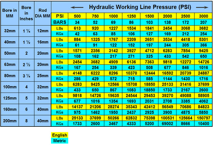

Hayrack is right. You can get more power out of your machine, at the same flow and pressure, but the movement will be slower due to the larger area in the cylinder having to be filled. Too, given that most machines are designed around a certain set of parameters, changing cylinders, or doing anything to significantly change the lifting capabilities opens the door for damage to the machine's frame, be it cracks, or worst case a catastrophic failure.
To see the differences in the forces applied by various sized cylinders, and some common pressure points, take a look on the chart at the provided link. As you'll see, even a 1/4 inch change in diameter on the cylinder (1-1/4" to 1-1/2") will make a change of nearly 1100 lbs at 2000 psi. Basically the higher the operating pressure, the more change imparted due to the diameter change to the cylinder bore.
