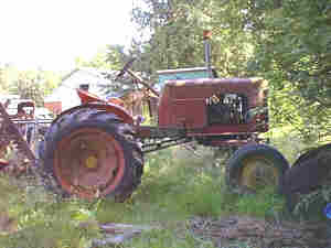

This tractor, manufactured by the Earthmaster Farm Equipment company in Burbank, California was made for only two years. The Model C came out in 1948 and was followed by the "CN" (narrow-width model), "CNH (narrow-width high-crop model), "CH" (high-crop), "D" and the "DH" (high-crop) in 1949. The main difference between the models was tire size, tractor width and cultivating height. The "D" series were about 20 inches wider overall than the "C" series. They all shared the same Continental N62 Engine. A full line of mounted implements were available that attached with the easy "Earthmaster Speedi-Hitch". 9 forward speeds were possible with it's 3 transmission ratios and 3 throttle settings.

The Earthmaster tractor is currently enjoying a surge in popularity. In size and horsepower, it is in the same class as the Massey-Harris Pony (they actually share the same engine even). Due to the increase in popularity as a collector's item and show tractor they have gone up in price accordingly, depending upon what kind of shape it is in. When restoring one of these, sheet metal and body parts can be hard to find. Engine parts however are easy to come by - you may not find them listed under the category of "Earthmaster" (most parts stores and catalogs don't even list this tractor) but you will find compatible engine parts under the "Allis-Chalmers G" category or the "Massey-Harris Pony" category since these too have the Continental N62 engine. You can also order engine parts directly from a Continental distributor since Continental is still in business. As a working tractor, they are great for cultivating chores in a large garden.
