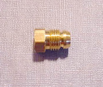

Ordinary ferrules from an auto parts store do NOT work well to replace the OEM nut with breakaway ferrule.
Here's what the parts catalog has to say: "NUT, hi-duty tube fitting, brs., 5/16" O.D. tubing, (strainer to carburetor pipe)
Product No: 222-503"
