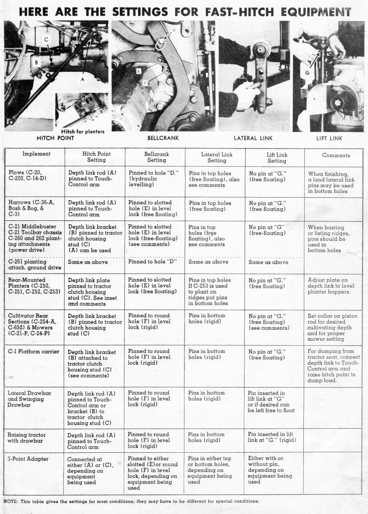

Was reading a previous post about how to setup a disc plow. I have this page that illustrates how to set various fast-hitch equipment. Hope it can be of use!
