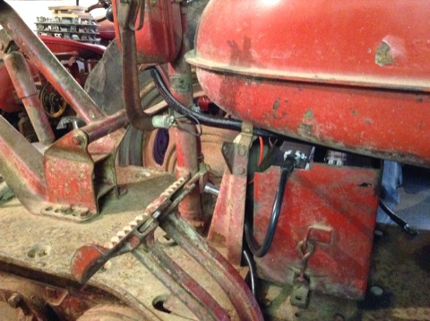

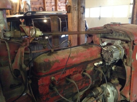

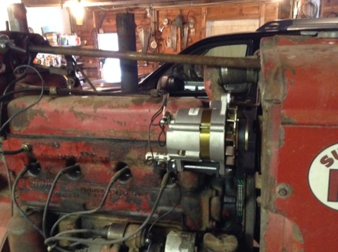

With Bob M's wiring diagram and charlieu's bracket I have my '52 SM converted over to 12v.
The Hitachi alternator slips right in with the mounting bracket almost like it was made to be there. Wiring was simple enough and I think it came out quite nice even on my not so pretty SM. Only other part I needed was a belt just a tad longer then stock, I think it ended up being 34 7/8".
