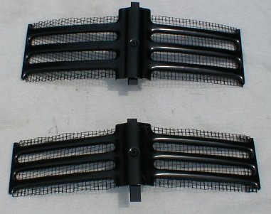

In Reply to: Grille Insert for M posted by Melvin Ware on October 28, 2010 at 21:08:07:
third party image
Theres a small 'bar" on the backside of the insert that goes in the center of the lower and upper sections of the grill where the hole is. Then the screw is tightend and this wedges in the insert. You have to have a pretty good, complete grill for it to work right.
