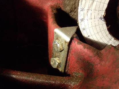

Hey guys, for those of you who want to time your super c dynamically, I�ve made a few notes about what I did. By the way, by dong this I found out that my timing was advanced way too much and my distributor timing weights were not working, basically they were almost froze.
First I made a pointer:
third party image
Then I downloaded a paper timing wheel, it was a jpeg file (just do a google search) and then sized it to 5 �� using word to match the size of the crank pulley, printed it, cut it out, and glued it to some cardboard. I then used doubled sided tape to stick it to the pulley.
