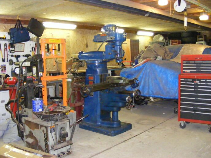

Blackhole49
11-22-2023 12:04:05
Report to Moderator
 Re: drill presses in reply to johndeeregreg, 11-19-2023 20:44:28
If you have the space, this mill was free and cost me $50 to convert to single phase from 3 phase. It will drill anything you can clamp under it.
Third Party Image
[Log in to Reply]  [No Email]
Hemmjo
11-22-2023 13:14:11
Report to Moderator
 Re: drill presses in reply to Blackhole49, 11-22-2023 12:04:05
Well I am certainly envious!!!!

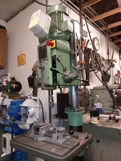

Some interesting replies here.
And I ain't saying any of you are wrong.
However, a drill press with a morse taper (MT) can put more torque to the bit than any type of collet used in a knee mill. A drill press with a MT tap holder will tap holes like nobodys business.
A 3 phase drill press can instantly reverse while tapping. Changing the tool in a MT drill press is much quicker than than loosening or changing the collet in a mill or in a chuck.. A drill press will drill big holes in steel day in, day out for years and not wear it out.
A drill press with power feed lets you adjust your speed/feed for optimum drilling performance.
A drill press is simpler to learn to use, quicker to set up and drills bigger holes faster.
I have an old knee mill. I like it and I use it for all the many things a drill press won't do.
But there is no way I would ever be without my drill press.
Third Party Image

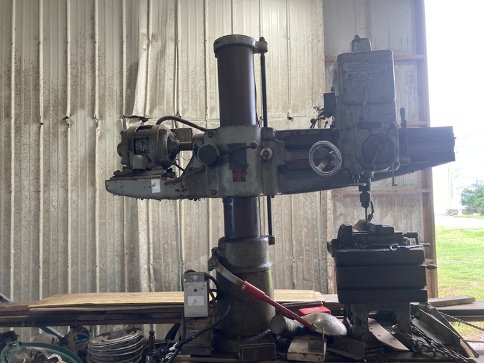

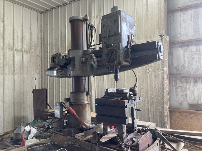

glennster
11-20-2023 12:46:07
Report to Moderator
i picked up a cincinati bickford radial drill press several years ago. i think i paid 1200 for it. has a #4 morse taper and came with a lot of bits . also has a phase converter to run single phase . its a beast. weighs around 7500 pounds but it will drill holes !!!
Third Party Image
Third Party Image

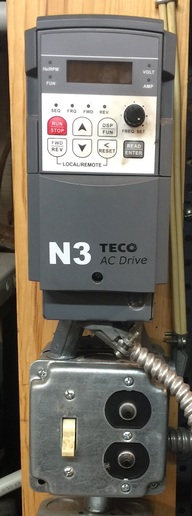

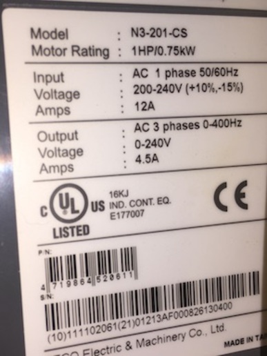

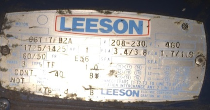

Hemmjo
11-20-2023 10:58:25
Report to Moderator
 Re: drill presses in reply to Kansas4010, 11-20-2023 05:31:15
I had no idea about VFD's either. I discovered them on a forum, I think it was the Practical Machinist, but I do not remember for sure. I got a TECO N3, made in Taiwan. It has been working fine for about 15 years. You need size the VFD to match the motor you are using. I have a 1HP Leeson motor on my 11 Logan lathe.
TECO N3
Third Party Image
Third Party Image
Third Party Image
Leeson 3ph 1 HP motor
Third Party Image
