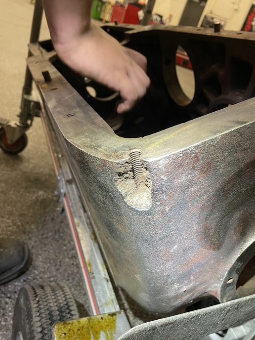

We are restoring a 1943 Farmall H and have this chunk missing in the case. According to the service manual, this case is "gray-iron casting." Searching online some people braze, some people weld. I have not welded or brazed cast iron before. I have an oxy-acetylene cutting torch, and several welders available including SMAW, GMAW, FCAW, and GTAW. I'm thinking it is best to braze this based on what I have read so far, but would like people's advice. Most people say to preheat, but some say that it is not necessary. The case is completely bare right now but obviously is too big to fit in an oven. There should not be pressure on this part of the case, and it is not structural. The bolt was actually still tight and unthreaded from the hole. I assume water got in the bolt hole and it froze and broke the piece off. I do not have the piece that broke off, the entire area would need to be built back up to get it to look correct. This is a high school restoration project to be used at competitions. It needs to be a good repair. What do you recommend?

I agree with redtom. You already got the guts out that will have to be put back. Might as well get a different case from salvage yard. If you go to a 'get it yourself' yard, you could probably save some work by choosing a donor tractor that has already been picked over but the case is still there.
I know you only really need a cosmetic fix here, or maybe not even that. Could probly be just fine to go back together without that one bolt. But the truth is, I don't think I'd use parts like that on a nut and bolt restore. Especially as common as H parts are in salvage yards.
If your going to do it right, you might as well get it right.

Since the remaining threads are enough to give the bolt grip I would go the epoxy route. I would also spend some time looking up the best epoxy to use and not automatically go the JB Weld route. If they can glue metal to the remaining portion of a bone (crowns in your mouth) I would think there would be some highend epoxy that would fill that corner out nicely and be a permanent repair - especially if it doesn't have to be a key in holding the bolt in. A small tube for $50 - $90 might seem excessive but it would still be many times cheaper than some of the other routes proposed here.
I would then also make sure the head of the bolt is sealed so you don't get water down that hole again.

I like the epoxy solutions others have suggested. It is a large hollow casting and putting enough heat in one place to weld it will (maybe) cause it to crack someplace else. Bates Corp in Indiana will have another casting. Ellis

What you're going to find in researching "epoxy repair" is a lot of grumpy old pharts crabbing about how it's not a good "proper" repair.
For an epoxy repair you need to get everything clean. I'd thread a bolt into the remains of the hole then slather on the JB Weld. Once the JB weld has had time to cure, the bolt should pop loose of the JB weld. Doesn't say much for the bond to the casting, but it doesn't have to be strong, just pretty, right?
If you're not going to fix it with an epoxy, I would TIG braze it with silicon bronze rod. You have fine heat control and a "cleaning" action with the TIG.
Should you choose the replacement route, I would give a TIG repair a try. It will be a good learning experience for you and your students.

Just to be clear, the reason for NOT welding/brazing the repair is that you can't possibly control the heat on a casting that big (it can be done, but not by Joe Homeowner) and unless it's heated and cooled EVENLY AND SLOWLY, it WILL crack and then you've created more problems than you've solved.
