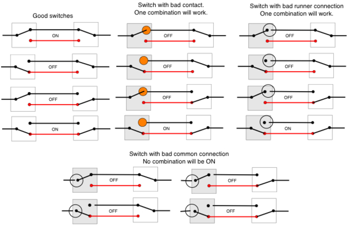

...the logic behind this and how it works to isolate one or the other.
Turn switch 1 up.
Turn switch 2 on and off. If it does go on and off, good
Next turn switch 1 down, then go to switch 2 and turn it on and off
If the light does not go off and on with it in one of those two tests it is the switch 1 that is bad
Doing it the opposite way tests Switch 2. Jim

Hemmjo
11-16-2023 06:53:28
Report to Moderator
 Re: Janicholson posted this Oct29Jim or anyone plse explain. in reply to JMOR, 11-16-2023 06:42:50
That is correct. Too many possibilities to fit on one page. Just pull out the switches and test them.

Janicholson
11-14-2023 11:01:39
Report to Moderator
 Re: Janicholson posted this Oct29Jim or anyone plse explain. in reply to JMOR, 11-14-2023 08:28:37
The failed 3 way switch (of the two switches) causes the light to not work when the opposing switch is in one of the two positions. Jim

Hemmjo
11-16-2023 06:10:44
Report to Moderator
 Re: Janicholson posted this Oct29Jim or anyone plse explain. in reply to JMOR, 11-14-2023 08:59:31
You really can not tell which switch is bad by flipping the switches. There is more that one way a circuit can fail. With multiple failure possibilities, the various if/then combinations do not always indicate the real problem. I cannot tell by flipping switches which is bad.
I made a sketch to try to visualize some of the possibilities. I do think it helps to visualize the issues.
Third Party Image
