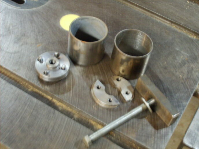

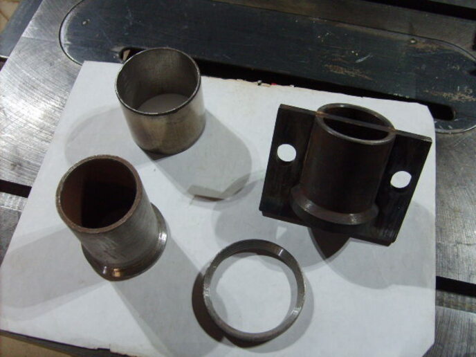

I'll add a little more info. For engine bearings it's grade 1 babbitt. 91% tin, 4.5% copper and 4.5% antimony. Got this from the JD collector center. I bought a 5 pound ingot, $105 from Victory White Metals in Cleveland and I'll probably use a bit more than a pound. I made up some molds when at my old job. A mandrel and pouring ring for the mains and two-sided one for the rods. Can pour both sides at once. Made pressing tools and a puller for the sleeve on the blind bearing.

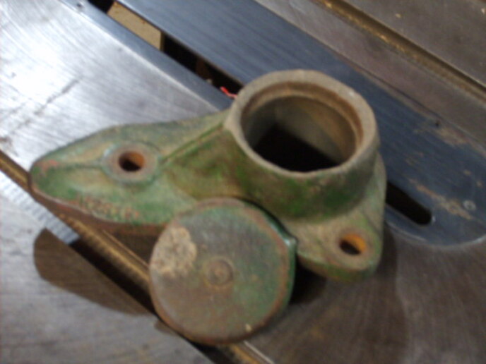

 Re: Babbitt in reply to Mike(NEOhio), 11-11-2023 13:30:07
Is that a JD H main bearing?
[Log in to Reply]  [No Email]
Mike(NEOhio)
11-12-2023 10:31:16
Report to Moderator
 Re: Babbitt in reply to Richard G., 11-12-2023 06:40:29
It's the right side main. The H has the clutch/pulley on the camshaft. All the others it's on the crankshaft. I made a puller to extract the steel sleeve but used the bolt to push against the bottom of the cup and you can see the result. I found another housing at a show and this time used a cross plate and pipe to press against the thick edge of the housing. One of the sleeves has the babbitt cleaned out, the other is as it was pulled.

 Re: Babbitt in reply to Richard G., 11-12-2023 12:14:51
When they were current the replacement mains were on an exchange basis. I guess they thought the cranks would never wear. Mine was bad on the left side getting progressively less left to right including the rods and the crank had some scoring. I had it ground at a local shop. Told the guy only grind enough to clean them up and not worry about the size, I would machine to fit. The worst only needed .005 to .010 but he took them down over 020 and matched the mains and rods. And he didn't duplicate the radius in the corners. This place builds high end competition engines. I was a little disappointed but it will work.
